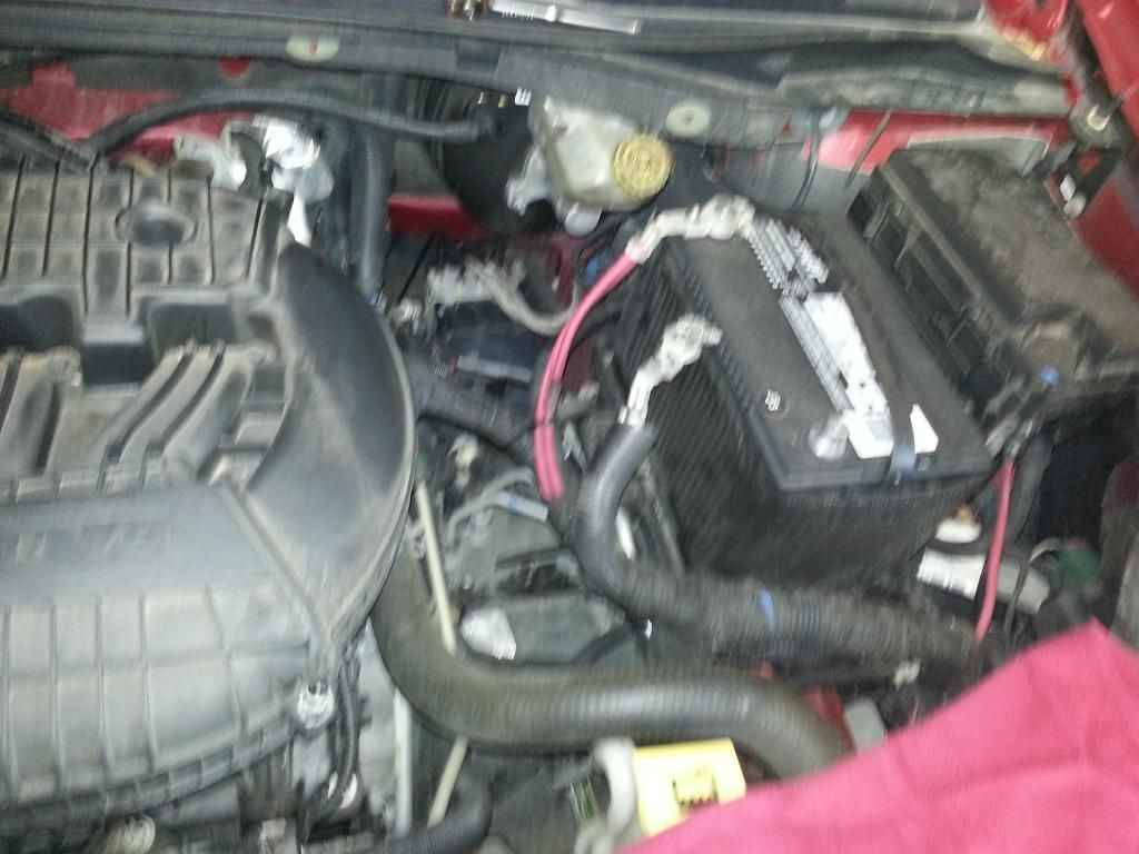

Here's the engine, minus the cover:
First step, unbolt the PS reservoir (10MM)
Remove the air box, upper and lower sections.
Remove the eight 10mm bolts to the upper intake plenum. Also two nuts and two studs on the front leading edge holding on the PS hose, two screws at the back holding on an EGR tube, and of course, several vacuum hoses.

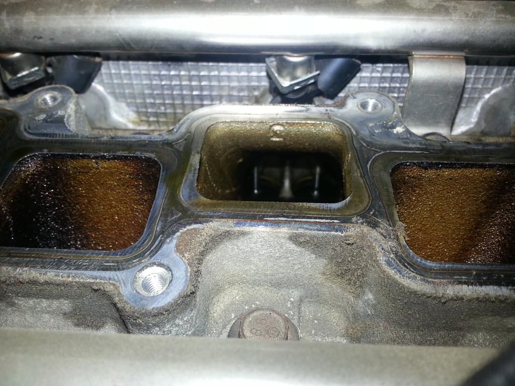

Underside of the plenum. Didn't realize it was a variable runner length intake until I saw the IMRC valves underneath.
