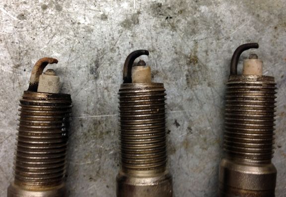

I pulled the front spark plugs and #2 has light colored deposits on it that #4 and #6 don't. From what I've read, I understand that could mean a coolant leak. Also, I shined a light through the spark plug holes. The top of the piston of #2 is wet and the others aren't.
What might be more likely to be happening: A head gasket leak, an intake manifold gasket leak, a cracked head or something else??
