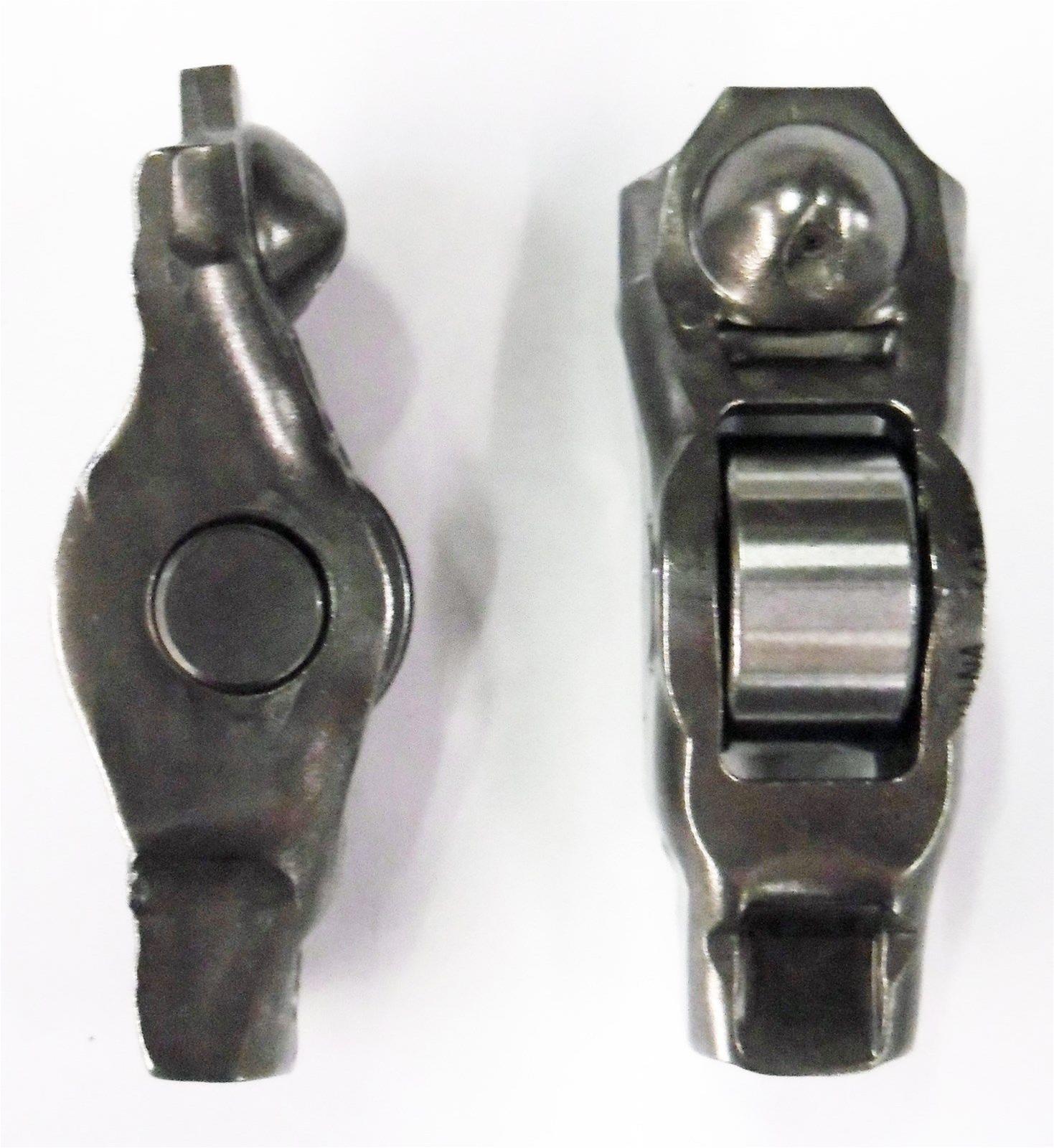

I finally got the rockers (took some time to get them up here) and they look great from what I can tell. The rockers are using the newer design with the centre rotating pin.
Have a few pics I took of the rockers below. So far they look promising. I'll know for sure when they are installed in the car.

Doesn't look like they give much room for the bearing to contact the cam before it touches the cage. Mopar AH revision has more than double that room.
How much space would you need? If it wears that much there is already a serious problem.
Really you don't need much at all, but with a smaller gap you have less time between a rocker failure and cam damage. The Elgins pictured look so close that they might tap the cage against the cam once the bearings start to wear down a little, but would otherwise be fine to continue using. Might work just fine, but clearances expressed in fractions of a millimeter make me nervous. :p

I finally got around to installing these. So far, I have only done the left bank, but here are some pictures as comparisons to the OE rockers that came out of the car. My van is a 2012, so it has the older revision parts. Still have to complete the right bank.
Top is Elgin and bottom is the OE Rocker. Spacing looks pretty similar to me IMO.
