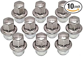

Impact wrenches eventually loosen the stainless steel caps on lug nuts, especially during removal where they have to pound on them more. That's not a Chrysler design fault. It's a wrong usage of tools fault. Chromed caps will get beat up as well starting with the first wheel work on the vehicle. Same for anodized coatings. Been there, had that happen.
From TireRack:
We do not recommend using impact guns or torque sticks when installing wheels. Impact guns can damage hardware and wheel finish. Some vehicles, such as Porsches, require the use of special sockets to tighten the hardware without damaging their anodized coating. Impact gun torque can vary widely from low torque (resulting in loose wheels) to extremely high torque (resulting in damage or broken hardware)

BTW, I got GREAT news. For anyone needing lug nuts, the PTC 98138 M12-1 X 43mm is the BEST replacements I found. They are still the 3/4 [19mm] lug wrench size too. These are the CORRECT height vs. many sold on the web being nearly 1/2-inch way too short and stubby !

Still a capped nut that can rust and swell and strand you on the roadside not being able to change a tire, I'll pass. The standard lug nuts are actually short; those ones are longer and are for steel wheels with plastic wheel covers secured by the lug nuts.

Yep, that's what I have, the steel wheels with the plastic wheel covers. The shorty lug nuts make it impossible to get at with the breaker bar. And if you do get them off, they fall behind the plastic cover and become lost on the ground under the van somewhere on the side of the road.
