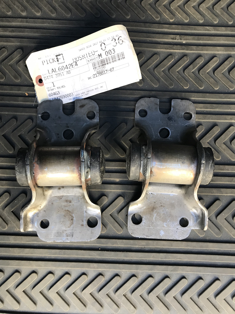

Hi!
Please hellp me to detect a correct part number of bushing installed in 474395(0/1)A(А/B/C)
(HANGER. Rear Spring. Left. ) (it's a outer link to factorychryslerparts (dot) com
04743 (Unknown digit)32AA

It's a new part (completed) for van without stow and go.
I need to replace only bushing.

Bushing with unknown (not detected still ) digit has a other size.

I tried applying Photoshop filters but I couldn't see correct digit. ((
I guess that this parts changes in assembly ((
Not cheap ((

Could be wrong, but I don't think they sell that bushing individually/separately. In other words, I believe you have to buy the completed assembly with bushings if you need the bushings.
Of course, there might be a suitable aftermarket produced by somebody or a generic bushing available that you can make work... but I'm not readily aware of it.

That said, the part number is 04743532AA.
May be. It's similar, but google, yahoo and mopar does not know about it :)
damned bushing...
I agree with ScuzziOne to find a generic bushing. Dorman and other aftermarket firms does not have one in own catalogs
This is correct. The parts manual lists only the complete hangers:
62453
62454

Bushing 201786 from MOOG/SKP -it's a bushing for leaf spring. )
I have it from DLZ chassis parts
The replacement bushings for the leaf springs and hangers are the same part. Or like the other guy said, buy the complete hanger.
Yes! You are right and other guy right too.
But these busning have a bigger diameter for stow and go van.
(thanks a lot for chrysler's engeenirs :confused:)

Correct. The bushings that you can buy separately for the leaf spring are a smaller diameter than the ones in this hanger.
