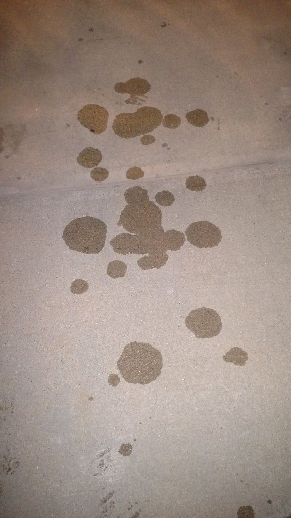

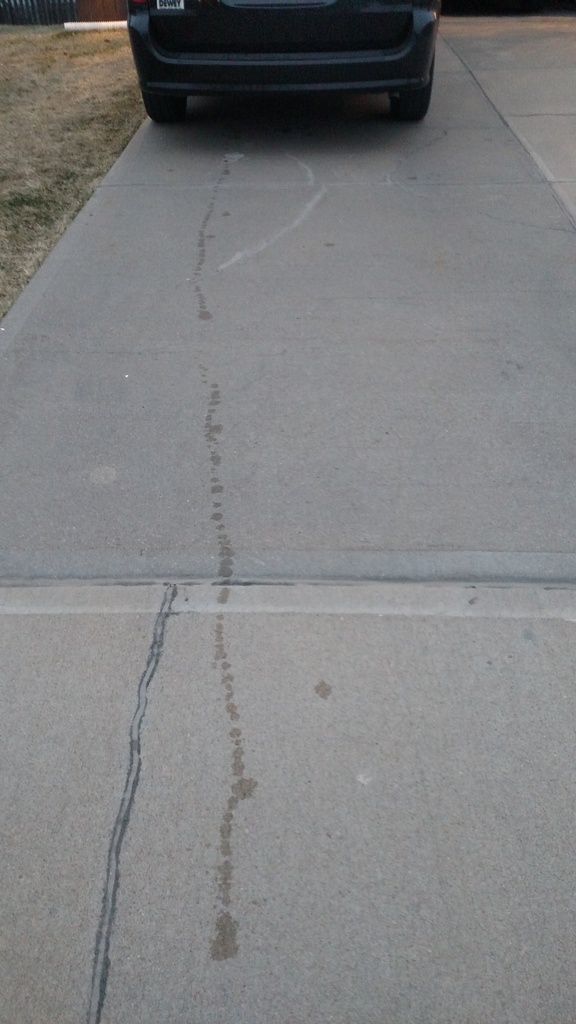

I checked the oil while sitting on my slightly inclined driveway, and it was at the low end of the 'safe' mark. I checked it again later on a level surface and it appeared a little higher. Best I could do as far as using a dowel was a McDonald's straw. I could see much if any oil on it after poking around the filter housing. I saw way more oil on the opposite end of the engine and underneath more towards the driver side. Here's what my driveway currently looks like.

And that's why they're picking it up tomorrow morning. I emailed the service advisor the picture of my driveway the same night I noticed it.

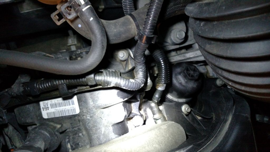

I took a closer look again tonight and did see some older oil down by the housing. Couldn't get a decent picture of it tho. Couple pics of wet oil on the other end of the engine to follow.
Very center of pic is a small accumulation of oil but there's a light film of it all over.
This is actually a shot of a oily spot near the filter.
I cant explain the first pic of the oil on the driverside...?
The oil in the second pic is classic spillage from the filter cap when removing it from the filter housing. There is a small amount of oil still left inside the cap when its removed, the lube tech did not rotate the cap/filter up fast enough and it spilled out and onto the engine bay. That being said, still doesn't explain the oil on the driveway...

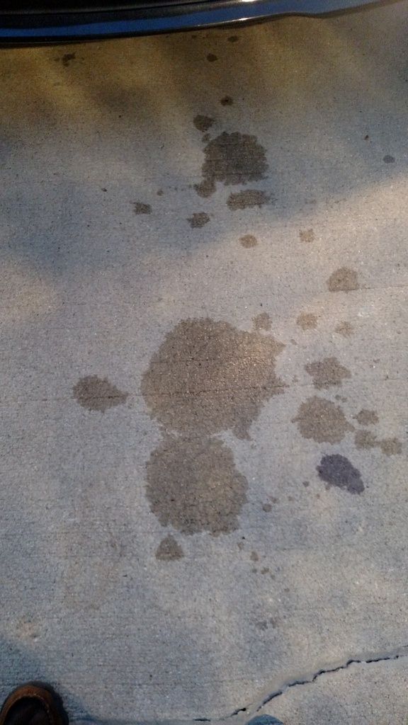

So I spoke too soon. Enjoy the pictures of what I found after getting home from church yesterday.
There's oil all over the bell housing again, and I can see standing oil in the same area on that side again as well as under the filter housing. When I checked the oil cold, it was about 3/8 of and inch below the "safe" zone.
