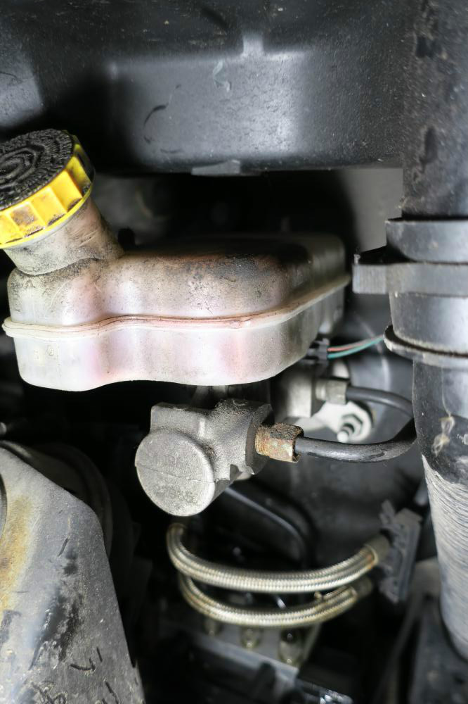

Thanks everyone for the help on this. I had time this morning to take a closer look, I removed the battery and battery tray to for a better view. There are two small metal mesh hoses under the master cylinder. The lower of the two hoses burst. Photos below.
Can anyone identify these two lines so I know what part I am looking for? And if you have any advice on remove and replace of these lines, that would be appreciated, too.
See less See more
OK, these are the primary and secondary lines from the master cylinder to the hydraulic control unit. Has anyone replaced just these lines before? If so, do you have any advice?
