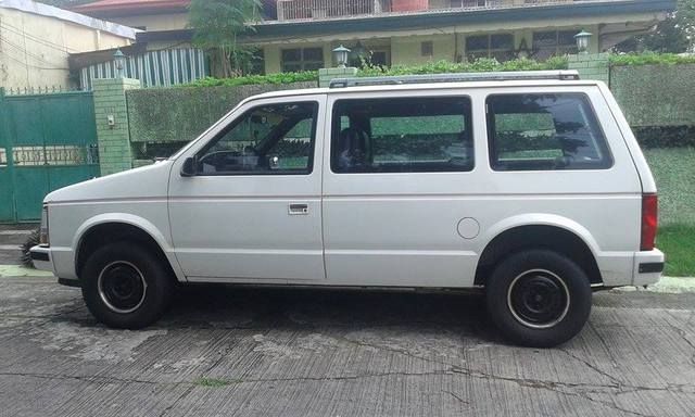

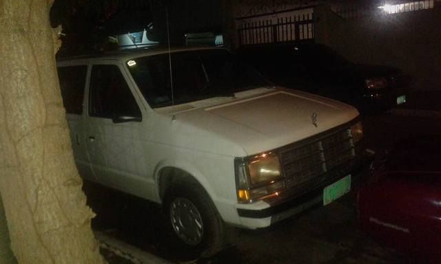

I just wanted to share my 2nd 1st Gen Minivan that I newly purchased. Its also 1987 Dodge Caravan with 2.6l G54B Mitsubishi engine but is an LE variant.
The day I got it.

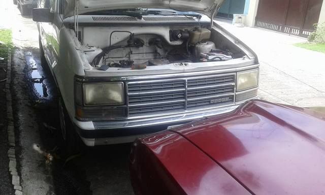

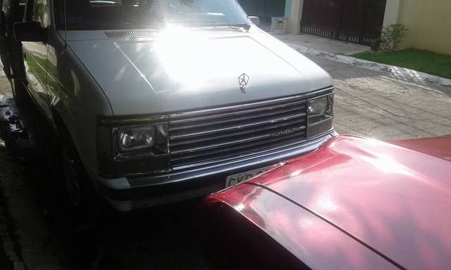

Changing to the ram van front fascia or the Europe Version as they call it.
Ram Van front headlights with Voyager grille.

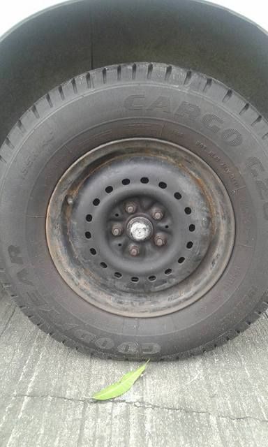

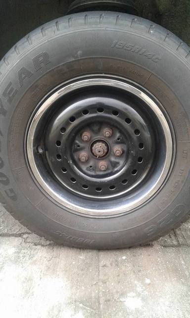

Decided to remove the hubcaps and buff and polish the steel wheels.

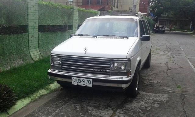

The finished product.

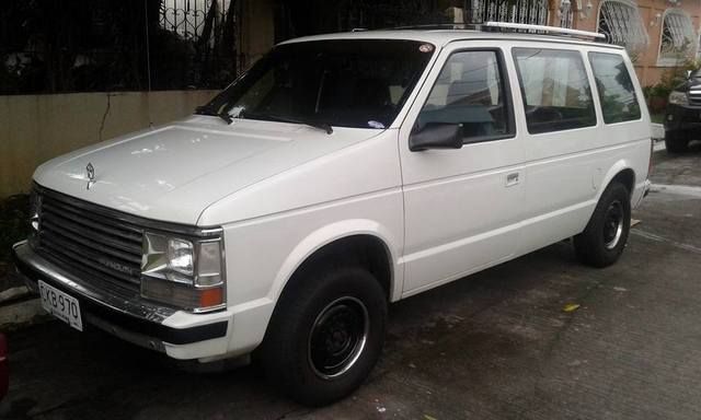

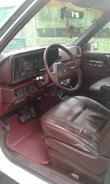

Gotta love that 1st gen styling.

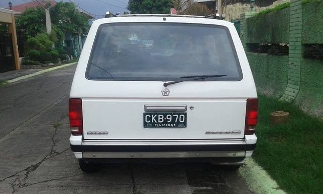

Some random pictures of the van.

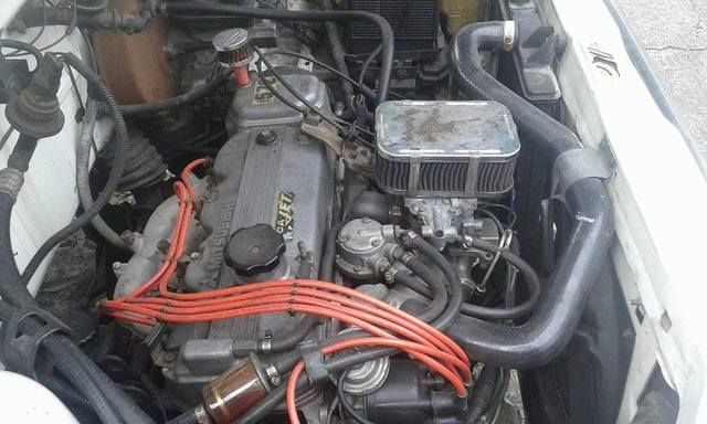

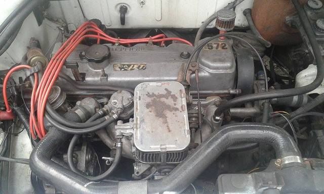

The Almighty 2.6L with a Weber 32/36 DFEV bought new in the U.S.A.
Awesome find! Is that still a Mikuni carb on it?
Damon, its the Weber 32/36 DFEV carburator, its the generic carb with adpator plates to suit the 2.6 engine. I still have a complete mikuni carb that I uninstalled in my other van and been planning to open one up but the screws on the body of the carburator wont get loose. And repair kits for the carb are hard to come by here in the Philippines.

That's just awesome. I have Weber 32/36 on my '86 Caravan LE and love it. It's so much better than the Mikuni. I replaced the Mikuni on my van once, and then a year later had to rebuild the replacement. A year after that I gave up on the Mikuni and friends and I spent a weekend installing the Weber. Performance and fuel economy both improved dramatically.

Thanks for the compliments dotyj, Did you change your jets on the Weber carburetor or did you just install it as it is when it came new? Mine seems to guzzle a lot of gas but there are no signs of it being rich or whatsoever but performance wise I really have nothing to complain about.
Sorry for the delay.
I kept it stock. We had to repurpose some of the old mounting hardware and fabricate some of our own hardware to make it work. But we did manage to get the cruise control linkage set back up and working properly.
The Weber allows for a lot less throttle pedal through but not annoyingly or dangerously so. It "feels" good.
I went from averaging 12mpg in town and 17mpg on road trips to 16mpg in town and 19mpg on road trips. I don't know though if this is proper. Other than being a year older than your LE I have the same set up.
I'll say this though. My van is likely someone heavier than yours due to the accessibility modifications for wheelchair use. The floor between the back of the front seats and the front of the rear row seats has been dropped nine inches and the sliding door is now hinged at the top and uses a linear actuator to open and close it. There's also a bi-fold wheelchair ramp that folds down the section of body under the door as it's deployed. It looks awesome when the door opens and the lower body panel and ramp deploy.
How does this fuel economy compare with any of the other 2.6 liter Caravans folks own?
