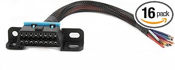

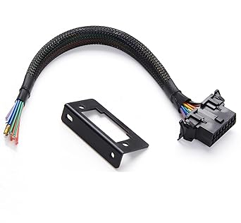

Just get one of the universal ones from Amazon and screw it in place. That way you know you have fresh pins. The plugs are all the same. You could take one from any modern car in the yard and make it work. It's just how they mount.
This one has options to screw it in place.
This one gives you a bracket to screw in place and clip the port to it.
#9 ·
Any of the options that look like this from that link should work and clip into the stock slot. You won't use the bracket.
