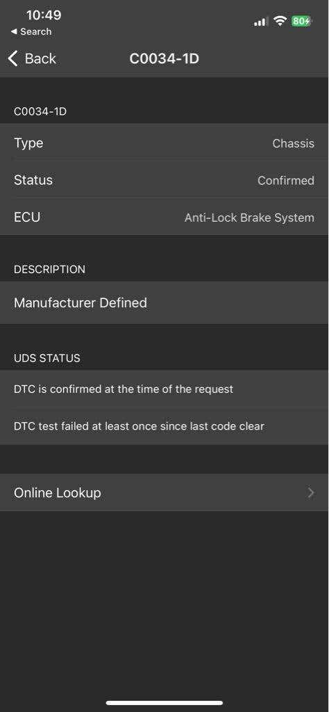

Yeah, looks like a stored/confirmed code since I had the ABS sensor issue. I’ve been able to clear comminication codes with OBD Fusion and the dongle. Maybe need a special scanner tool to clear ABS codes? Shouldn’t they clear automatically if the light isn’t on and the issue is fixed?
As it can be seen from the picture there’s no description of the code. It says manufacturer defined.
