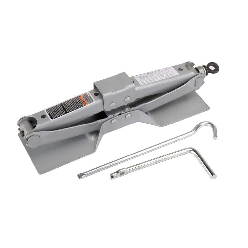

Anything wrong with just ordering a Mopar replacement jack? Can get one online for $119 shipped. All the aftermarket ones I’m looking at have poor reviews and I’m unsure of fitment. Was also thinking of going bottle jack route if I can find a size that works but looks doubtful.

Rockauto sells one like yours: Garage Equipment Jack Scissor Jack Parts | RockAuto
That large bottom gives stability but only on a uniform surface.
Your jack should be able to lift one corner, likely even one side, unloaded, without trouble.

On the factory mopar jack, can just a socket wrench/ breaker bar be used to crank it up/down? Really thinking that jack is my best option- and it will fit in the storage compartment.
#21 ·
Ended up ordering a Mopar jack online from a Texas dealership. Came with no case or wrench or even a shipping box. Just had a shipping tag attached and a manufacturers tag with December 2019 date code. $120 with the shipping so a rip off but definitely better quality than the $25 one I purchased at hardware store. It’s made in Canada verses China. The turn bolt and threads seem heavier duty and turns smoother. Sprayed some WD40 on the pivot points, wrapped it in an old hand towel and put it in the designated storage compartment. Hopefully I’ll never need it.
