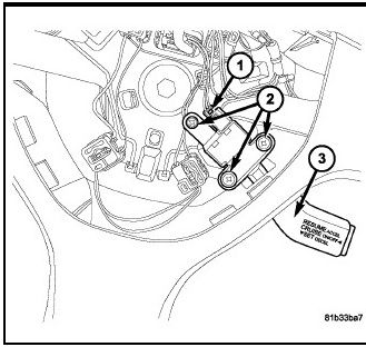

the service manual mentions this for the switch:
WARNING: Disconnect and isolate the battery negative (ground) cable before beginning steering wheel removal or installation. Allow the front airbag system capacitor to discharge for two minutes before removing the steering wheel or any front airbag system component. This will disable the front airbag system. Failure to disconnect the battery could result in accidental front airbag module deployment and possible personal injury.
Do not place a non-deployed airbag face down on a hard surface as the airbag will propel into the air if accidentally deployed, and could result in serious or fatal injury.
1) Disconnect and isolate the negative battery cable before beginning steering wheel removal. Allow the front airbag system capacitor to discharge for two minutes before removing the steering wheel or any front airbag system component.
2) Remove steering wheel air bag.
3) Disconnect electrical connector (1) from speed control switch (3).
4) Remove screws (2) from speed control switch (3).
5) Remove speed control switch (3) from steering wheel.

I forgot about this thread, but changing the switch did fix my issue.
It was pretty simple, I disconnected the battery for 10-15 minutes before I started to allow the charge to dissipate in the air bag. Then I took out the two bolts that held in the air bag. The screws that hold in the switch are behind a small cover on the dashboard side of the steering wheel.
Since my nearest dealer is now a hour away, I got my switch off of Amazon. It works great, except for the fact that it is green instead of blue like the old one. Even though the part number on the switch is the same. But it isn't a big enough deal for me to worry about it.
